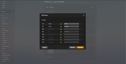

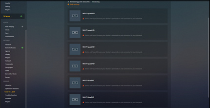

Plex DVR is ridiculously poor at managing tuners. When working properly, you have to tune each tuner individually, and you have to select the channels you want access to individually as well. For me, with 6 dual tuners, this takes a ridiculous amount of time, especially when in the UK channels are changing almost on a monthly basis, and having to retune at least that often. This would be incredibly frustrating, as you should just be able to tell the system which channels you want to receive, and have that data applied to all tuners, with the option of being able to adjust tuners individually if required. However, the tuning system does not operate very well at all. The channels do not match the channel numbers, they are not in order, and there are often multiples of the same channel, which if accidentally selecting more than 1, means that the system gets upset and refuses to accept your settings! Sometimes the tuners just disappear, and during this, sometimes programmes are recorded, and sometimes not!
