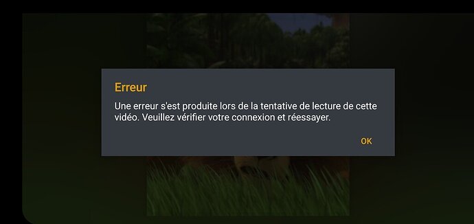

Plex + Android tv not working
Server Version#: wd cloud home
Player Version#: 8.1.17.1.25326
Hello, for several days it has been impossible for me to play a video on my smartphone or my android tv. When I am on the application I can see my films, but when I launch the message “an error occurred while trying to play this video, please check your connection and try again.” My videos are available from the plex website … therefore available … My My cloud server is connected to an orange livebox 4. I assigned a fixed ip to my server and opened the 32400 ports of my box. I do not understand what is happening, everything was working perfectly and overnight nothing. do you have an idea ?
I have de same problem. I cant see nothing in my android app and my plex media server doesnt connect correctly, so my remote access is not available either.
I also have the same problem on my Huawei phone. Used for 18 months while power walking then suddenly overnight will not play any music at all. I get the same error message. Still works fine on my Acer laptop, iPad pro and LG tv.
I dont know what can i do. Remote access is not working neither
I have the same problem.
I’ve found a temporary workaround. The DLNA server from plex still works. You can use VLC for android tv to play the content of your plex server.
Ohhhh thank you !!! You save life !! Thank you ! :+1::+1::+1::+1::+1::+1::+1:
your welcome. If you need help let me know. If someone find a solution to fix the problem properly let me know. The plex app still works better (if it works).
