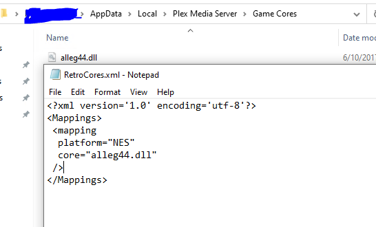

This is what I have atm, is this not correct? It doesn’t seem to run the emulator.
Also, the Game Cores folder does NOT exist, this guide is a little misleading. There is a Games folder, but no Game Cores.
Did you install the included games? It would have also installed the core needed to play those.
No. The platform needs to match exactly to what is shown when you look at the game in Plex. These are standardized names, you can’t just what you want. For NES the correct name is “Nintendo Entertainment System”.
I did change it to that, I have been trying but it still just says the core isnt there…I will get back at it romorrow, thanks for the help.
