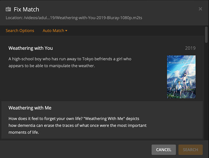

Auto matching doesn’t work when new content is pulled in and when I manually run auto match I get the error "No matches were found using this agent”. Yet, if I run a manual match the first result is the correct one every time and when I select the first match it happily updates the metadata no problem. When I run Refresh All Metadata on the library I get the search icon on all the thumbnails and on some of them afterwards I get the little tag icon as if it’s updating the metadata but nothing changes.

Why does auto matching not work when the first manual search result every time is correct? Should auto match not just take the first search result?
I did some renaming experiments and got it to auto match by removing the dashes. I find this odd since this used to work and this has been the naming scheme for my content for as long as I can remember and has never been an issue. They must have changed something with the matching in an update. Frustrating. Dashes instead of spacing causing match failures is ridiculous IMO.
