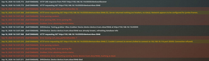

I had Plex setup with an VBox which grabbed 192.168.0.69 on my local network.
It needed replacing and the new box has grabbed 192.168.0.56.
I deleted the old DVR entry in Plex and added the new one. Screenshot 2020-08-24 at 17.44.53
Despite the admin screen showing it’s found the new IP address, it won’t tune.
A look in the server logs shows that Plex is still attempting to tune to the original IP address. Here’s are some relevant log entries from the Plex server log:
My question is how can I force Plex to look for the new IP address and not old one?
(Note: I could try updating the VBox’s IP address but I prefer to not to hard code this in the device if possible).
