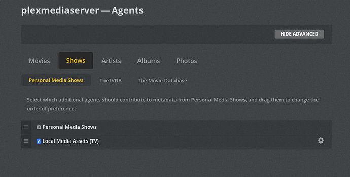

I was trying to refresh metadata for a tv documentary and plex cannot find the show. Although I can manually find it in TvDb. On further investigation I noticed that TvDb plugin is not running despite restarting plex server multiple times.
This is what is running
