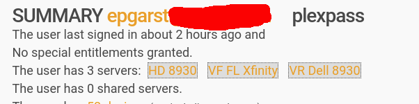

@epgarst_gmail.com
No servers by that name
Screenshot from 2020-10-06 14-35-06
Wrong account?
That’s the friendly name of the three servers.

You have 3 stale servers (not seen in a while )
You show no active servers.
Wrong account?
