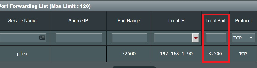

Have you made any router changes since you posted the screenshots at 20:04 your time?
The port forward screenshot showed the local port as 32500 and not 32400. Local port should always be 32400
