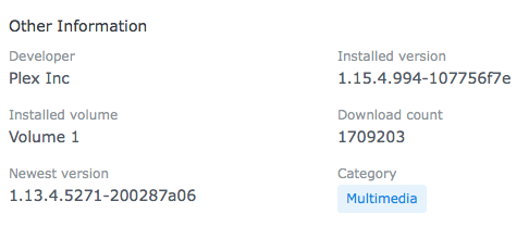

Strangely enough it appears to be regular occurrence now that when shown not available on the PMS Remote Access screen - the PMS “General” tab reports incorrect version of 1.13.4.5271 but beside it reads “Up to date”. When I click the “Retry/Apply” button beside the remote access port, it quickly goes green again and will be available for another half day or so. The version then immediately updates to the latest release above. No matter the later version installed over the past few months, when the server becomes unavailable, it reports 1.13.4.5271. This version happens to be the latest available release in the Synology Package Center, so I’m not sure if this is a unrelated bug - but seems a strange coincidence the incorrect version reporting happens only when the server becomes unavailable.

This is concerning and may be relevant to the problem. Wondering if two instances of Plex Media Server get to run at some point 1.13.4.5271 and the new installed version 1.15.4.994,

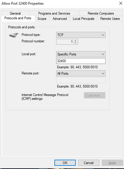

Same issue here and also very frustrated…I’m not sure what to do anymore, I am on Verizon FIOS fiber optics so I have a very good connection 75up/75down and my switch in my home is gigabit (everything is hard wired that matters). I was at the newest Plex version 1.15.4.994 but am now at BETA version 1.15.6.1079, My Plex server is a Dell Server running Windows Server 2016 with power options at optimal performance. I’ve tried everything I can think of so I am pleading with someone for some input. I’ve changed it to run Plex as a service thinking maybe the service was failing but it is still enabled even when Plex stops responding remotely. Now here is the issue, everyday without rhyme or reason my Plex server becomes disconnected, the service is still running however I cannot get to it remotely, starting Plex again gets it back up and running but it is no longer consistently connected at all, in the infancy days of Plex I ALWAYS had a solid connection, looks to me like a wide array of people are seeing this. I’ve tried every conceivable option in Plex without a resolution, I even created a task to reboot my server with a powershell script and task daily @ 5am, when it comes back up the service starts and it is running again but it could be anywhere from 3 to 12 hours before it mysteriously drops again. I’m a little frustrated because after paying all that money for a Plex Pass I am still having these issues and unable to use my Plex or Plex Pass to its full potential. Give me some feedback please, I turned on debugging and provided the log below, this is a PMS problem, it is evident because all of my other port forwarding works as it should. PMS has PMS! Looks like the Plex Pass was a huge waste of money for me, do the refund money for Plex Pass since all these issues are never resolved or even taken seriously?

I created another inbound rule in Windows Firewall to allow port 32400 (my port choice) and am crossing my fingers, so far it is working. What I noticed when going through the inbound rules is despite explicitly using 32400 I saw nothing in any of the Plex rules that explicitly opened that port 100% inbound. If this worked for you please let me know. What concerns me is IF this is the problem why isn’t it fixed with a newer build?
