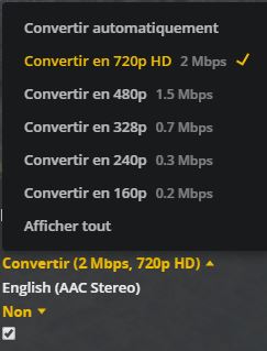

Hello there,
I’ve noticed that plex desktop player won’t give me the option to watch videos in more than 720p while the same video plays in 1080p on my android TV.
The option is just not there.

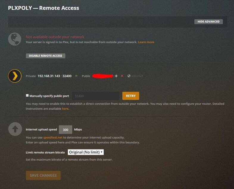

My server sits behind a 300mbps connection and I’ve set internet playback quality to 20mbps 1080p.
plx1
I just don’t get why the image is great on the TV and terrible on the desktop.
Do you guys have any idea of what’s going on ?
What happens when you click on “Afficher tout ”?
Well the “afficher tout” “display all” is already open. :slight_smile:
I wonder if your connection is in relay mode (meaning you don’t have a direct local connection to your server)?
https://support.plex.tv/articles/216766168-accessing-a-server-through-relay/
You are right, it’s in relay mode as I need to forward a port on my router. I thought UPNP would do it but..nah. I’ll make sure it properly forwarded.
However this doesn’t fully explain why the image quality is great on the TV but terrible on the PC.
weird
Well now I’ve forwarded the port to make the server fully accessible I can select 1080p on the desktop player. However the image feels a bit laggy, jittery on the desktop. (running i5, 8gb, ssd)
I still don’t understand why the quality was 1080p on the TV + smooth, while the server was in relay mode. :expressionless:
