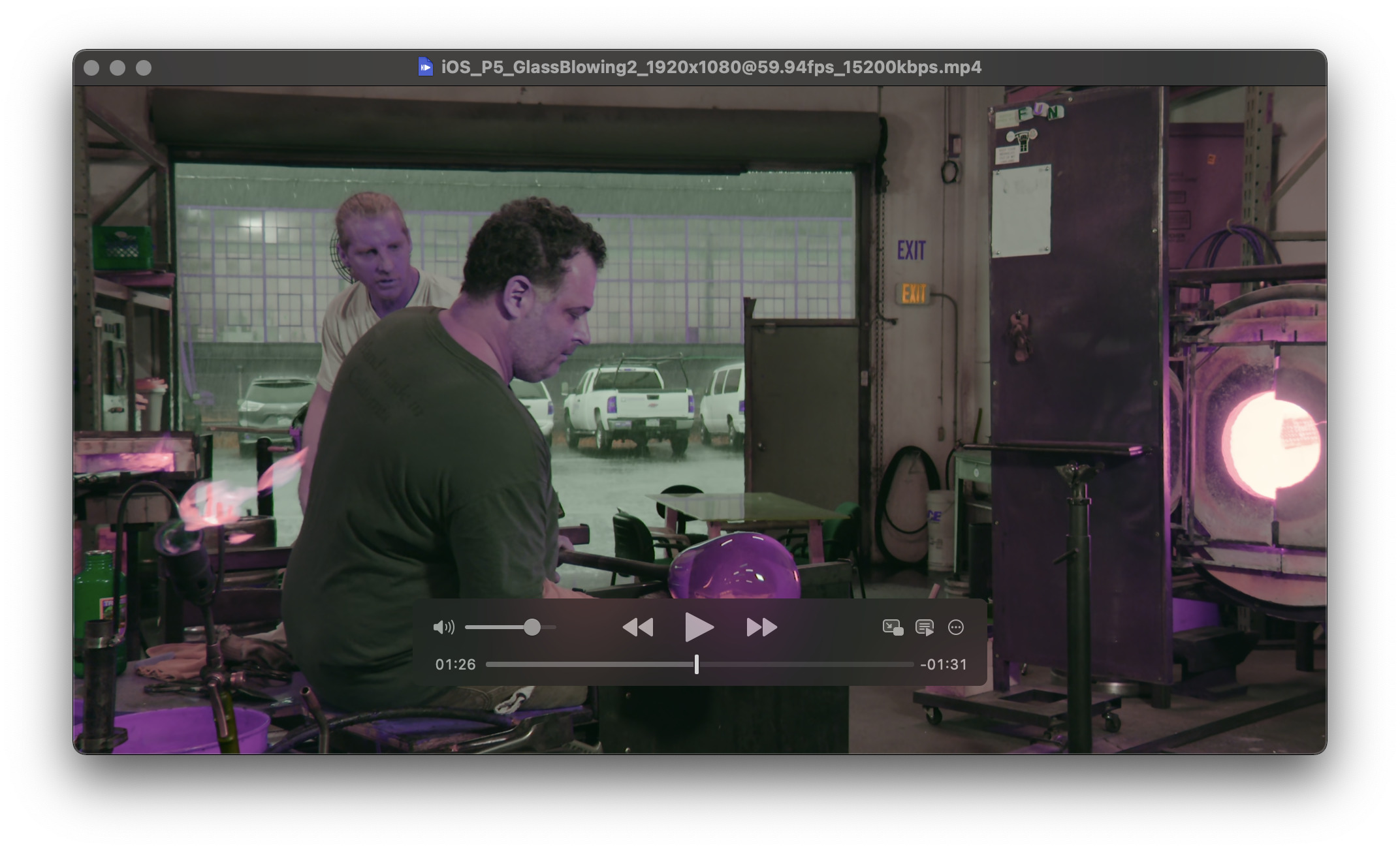

Plex displays wrong colours with Dolby Vision on AppleTV 4k
Plex triggers Dolby Vision in Profile 7, but as alluded to above it’s actually HDR 10 fall back, sort of fake DV.
Weren’t samples already shared and problem acknowledged by iOS team? Why is this still a discussion? I have said it before. Getting Plex to acknowledge bugs and problems and is huge issue. We’re at the 10th month mark of this issue.
Think we need to band together, we are not requesting something new here. Plex formerly advertised and acknowledged that DV is supported on ATV and is contractually bound to honor that. I’m at my wits end on this one. We have another running thread on HDR 10 on new ATV 2021. How can we band together and take up issue on social media or something?
I just think that this thread for months was misunderstood by those at Plex who were able to fix the issue. I think they thought we were asking for something that could not be supported, and so it just meandered on without resolution.
Can you please comment on the current state of affair regarding this bug and provide a tentative timeline when this issue will be resolved.
I don’t think this is too much to ask. Is it?
A video player not being able to play videos properly for 5+ month is not a good look.

So it isn’t displaying DoVi at all when playing back a P7 file.
This thread is about getting DoVi P5 support working in Plex, because that is what the ATV4K hardware supports.
Since essentially no consumer DoVi encoders exist outside of hardware (e.g., an iPhone 12 recording DoVi P8.4), and those don’t prodice P5 files, it isn’t easy to provide sample files.
Are you able to acknowledge for us that you’re working on DoVi P5 support at various DoVi Levels? Can you provide some form of specifics on where you stand, what the challenges are, or what you need from us?
If you still need sample files for DoVi P5, what Levels do you need?
