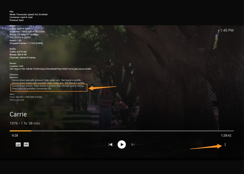

During playback look bring up on screen controller and look at playback info and it should give general reason why if it is transcoding
Thanks for the replay - sorry for the simple question but where do I find the “screen controller”? I can see info from the Dashboard and such which tells the video is playing but no reason for the transcode. From the Plex Dash application it does say Transcode (H264, 2Mbps) which prob explains the big downgrade in quality.

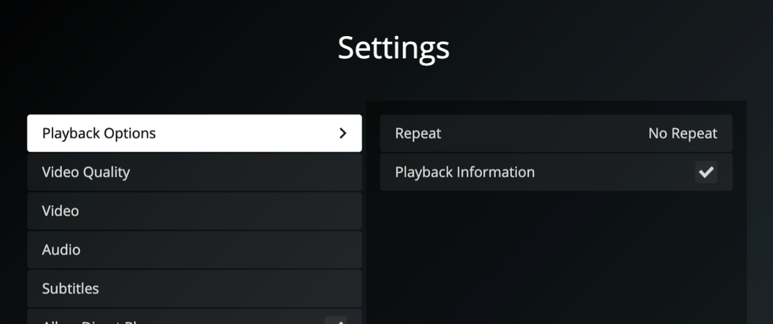

When you are playing something on your tv click something so the overlay with the progress bar, play button etc shows up. That is what i mean by on screen controller like where you could enable subtitles for example. on the right side of the play button click the three dots which will take you to pplayback settings like in my screenshot below. Enable “Playback information” and then when you go back to player is should have info on why it is transcoding.

Got it thank you - It says the server is on a WAn and that Maxbitrate is 2000 mbps which is incorrect - where do I control that setting so that I can increase the quality?
