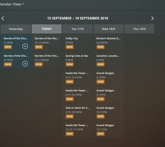

Can anyone explain why I am getting the same show recorded at the same time, using multiple turners ? Please see screenshot
Anyone have any suggestions on this, its rather annoying ?
This behavior is explained in my post here New Plex Guide Very Poor in UK - #291 by sa2000

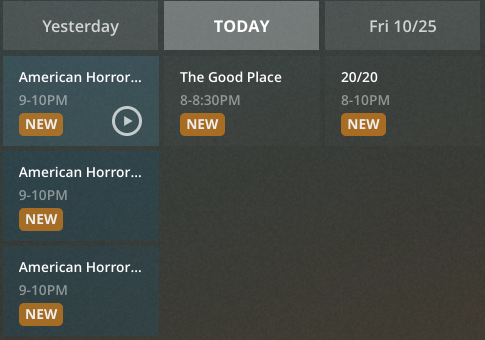

This is what the DVR schedule is showing:
So, you can see it’s showing the same program 3 times for the exact same airing.

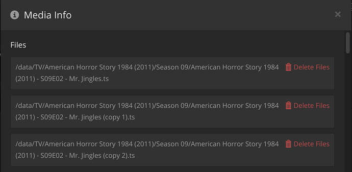

If I find that recording in my library and get info, I see this:
As far as I know, it’s only using 1 tuner, so it’s actually only recording once, but it keeps making these duplicates. I’ve had the issue in the past, but now this is the only show where it seems to happen.

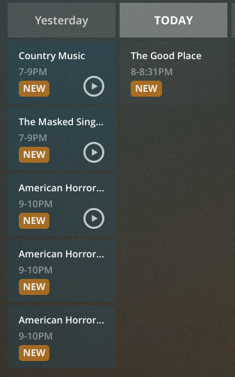

@sa2000, same experience last night.
Everything looked normal when it was recording.
Screenshot%20from%202019-10-16%2021-28-45
But when I checked it this morning, you can see it shows up multiple times in the DVR schedule and there were multiple files saved.
Screenshot%20from%202019-10-17%2005-12-27

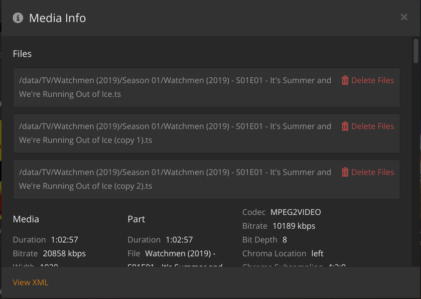

This issue normally appears to be series specific, and once it happens, it always happens. However, the second episode of Watchmen recorded last night and it only recorded once! We’ll see what happens on Wednesday with American Horror Story.

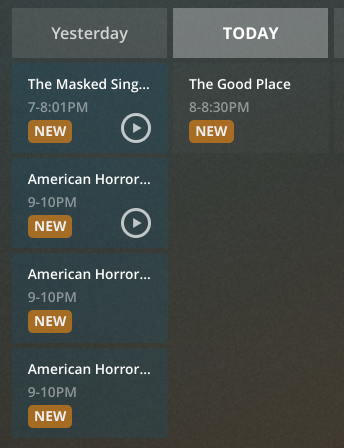

Plex has a cool new feature: The ability to record in the future! :laughing:
Before yesterday the schedule to record Poldark On Masterpiece S5E5 looked correct:
Record once on Sunday (yesterday.) It successfully recorded, but now doesn’t show that it recorded yesterday, but that it successfully (will?) record(ed?) tomorrow.
One of those three tomorrow even specifically says it successfully recorded tomorrow! Too funny.
While weird it is recording successfully, if multiple times. I just have to do cleanup of the extra copies.

Also, @sa2000, I was wondering what would happen when American Horror Story recorded this week because Watchmen seemed to fix itself, but it did the triple recording again, so I have no idea what’s going on.
