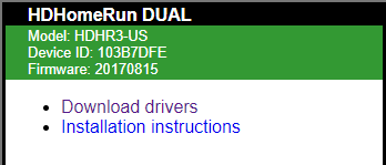

I have a HDHR3-US:
Did not currently have it configured in my main Plex Server but added it to show it is configured and shows are recording using it.

hdhr3-us:
Model: HDHR3-US
Device ID: 1036F851
Firmware: 20170815
