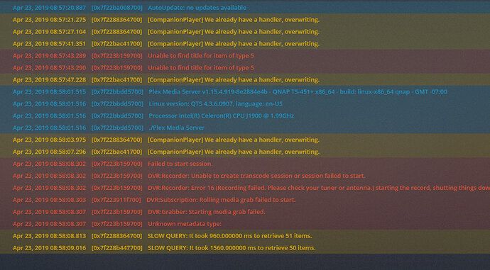

I’m having similar issues with PMS vers 1.15.4.919. See screen shot below from the console. Pretty much all channels are failing to load from HDHomerun Prime box
