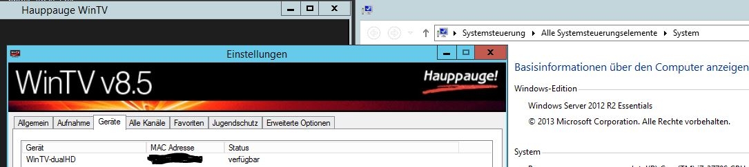

That’s strange. I have WinTV 8.5 still installed and did a qick test. After the start, the setup assistant was started immediately. Just like it should be. And the device is also displayed in WinTV.
