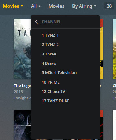

Because Plex doesn’t have a grid style EPG, the categorising of movies vs shows/episodes becomes very important and this is the part that is disappointing. Out of frustration I have been using WebGrab+ and modifying the script to produce my own XMLTV file and better categorisation of movies. I am only scraping ONE source (Freeview) to get this. I have tried an XMLTV file someone else is working on that is currently also scaping a second source (TVNZ) for better accuracy. So why can’t Gracenote do a better job of this?
See below examples from my XMLTV vs Gracenote. This is from 8 channels turned on in both cases. XMLTV version has 28 movies, Gracenote 12. In the below examples XMLTV has movies on all 8 channels, Gracenote only on 3 (and all TVNZ channels).
