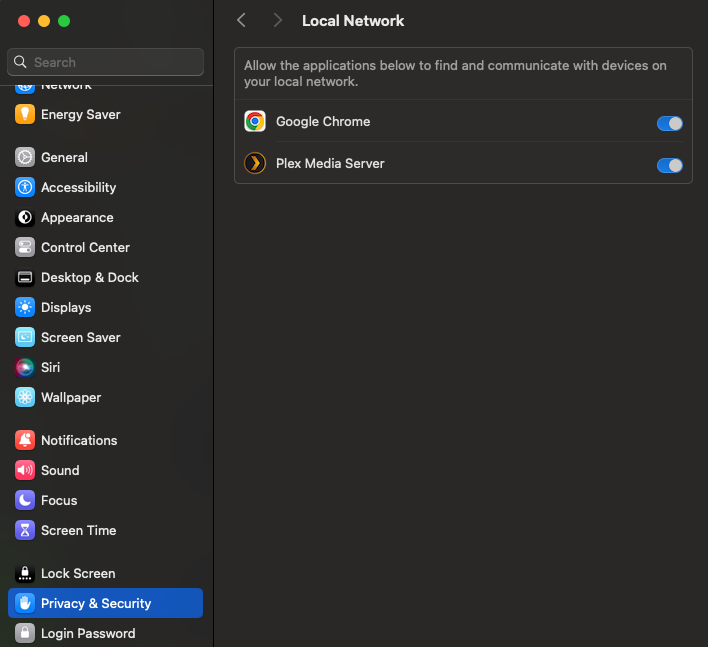

I have an Mac M1 that is connected to a Synology NAS for it’s media content. I have not observed this issue yet. Some things that I did notice with the new Mac OS update was a prompt to allow PMS local network discovery.
If you did not see this prompt for whatever reason it might be good to double check that this is enabled.
Settings > Privacy & Security > Local Network
This :point_up: is just my initial observations so far and might be unrelated. We will need logs to better understand the issue.
Thank you. It is enabled on my Mac. I will DM you a link to my logs.

Also confirmed that the security & privacy setting is enabled.
