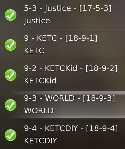

some examples of the channels and maping I am getting on Sagetv
there are many more channels that I get from in the clear QAM

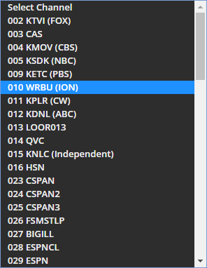

Can you grab some screenshots of the DVR setup screen where you select the cable provider and the channels Plex is displaying? I assume since you mentioned 300 channels that your are using the “Madison Communications, Inc - Digital” Cable Provider/Program Guide since the non digital only lists 71 channels. If I select the provider I see the following channels at the top of the list.
If you could grab screenshots showing all the channels on the left side of the selection screen. Hopefully this will allow me to see what you are getting. Screenshot is from one of my test servers, channels of course do not match since I am not in the St. Louis area.
