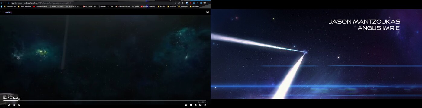

Hey, lookie here, The same files not playing through plex on my TV is playing through Emby, From the same host machine, Through the same network. with all the same configurations. all the same ■■■■■■■ PERMISSIONS. also able to play directly from media player.
Man. Just because you have Emby configured right, does NOT mean you have Plex configured right. They’re different apps, with different configuration requirements. Just because you don’t understand why it’s not working, does not mean it is an issue with the software.
Yea, ok. all that means is PLEX is having issues with that file. It shouldn’t need to transcode. It should be able to direct play.
