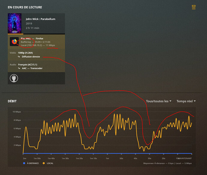

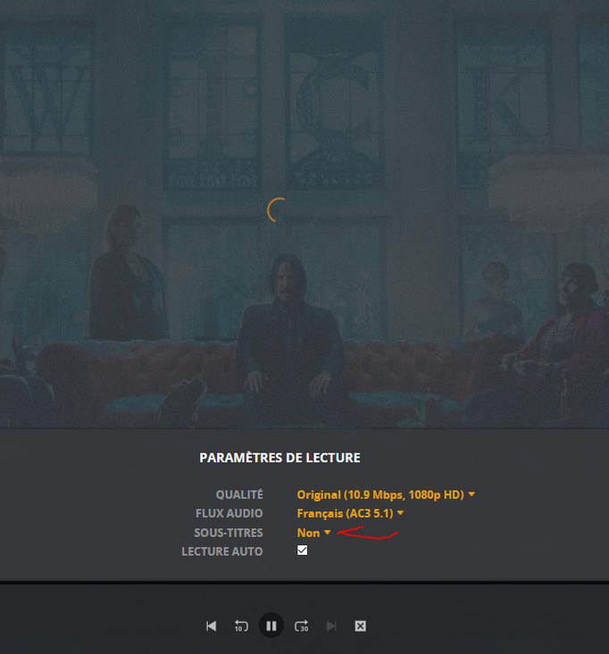

I didn’t ask to burn subtile

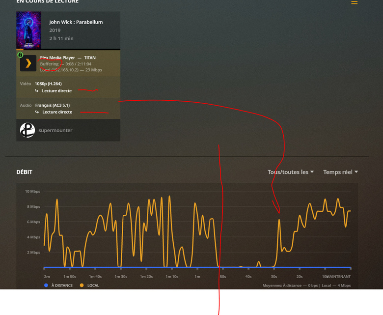

I still even suffer of buffering with direct play
Now here with full direct play sound & picture with Media Player
Still Buffering a lot

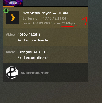

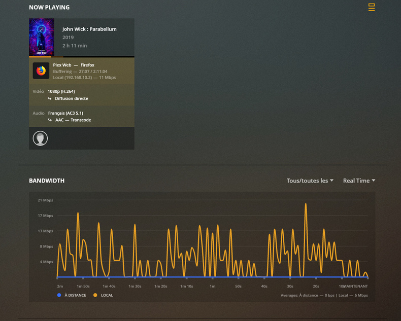

here another try
don’t understand why dashboard show me 23Mbps but the movie is 10.8Mbps
and I checked my routeur wan usage …the HTTPS Stream don’t goes up than 11Mbps
The movie started automaticely as transcoded @2MBps but few second after I switched to Original Quality & the buffering apaird after few seconds

Network topo is really a simple structure
Nas with 2 link not agreated to a switch directly connected to the router/gateway
Client connected remotely to the Nas VPN.
All are wired.
setting IP wan treath as local and no bitrate limitation.
ISP band give speedtest 278Mb/s in & 28Mb/s out.
