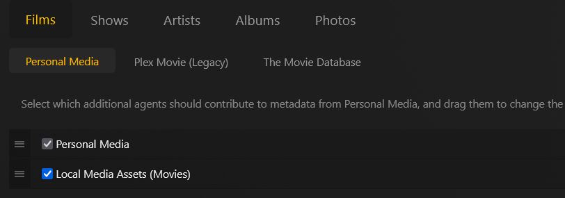

However, since yesterday I am not able to automatically scan metadata. Posters don’t get included, all the plot/synopsis from IMDB also don’t get included. I have not made any changes to the Agent settings at all.
Could someone please help ? I have included the settings that I see on my Agents page:
What agent is your library actually using (Manage Library > Edit > Advanced)? Debug server logs might also be helpful, or at least your PMS/OS version. Outside of that, have you done any initial troubleshooting steps?
As an aside, nothing under Settings > Agents affects the modern agents (Plex Movie and Plex TV Series), so the settings in your screenshots might not be relevant.

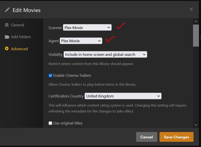

Thanks very much for the reply. I have checked the Advanced settings of ‘Manage Library’ section, and it looks like the following:
I tried changing the selection drop-down of ‘Scanner’ but I can’t find something that seems to change the metadata update of my movies.

Since you are using the Plex Movie scanner and agent the first screen shots you posted no longer apply to you
That is only for the older legacy agents
All of your relevant settings are in the same advanced tab of your last screen shot

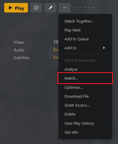

Does manually matching work, or does that not return any results either?
I tried searching for ‘Fix Match’ but can’t seem to find it in my menu below:
Again, I tried uploading a new movie into Plex, and as expected, no metadata got updated.
Since it hasn’t been matched at all yet, the option is just ‘Match’, not ‘Fix Match’:
