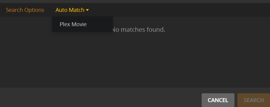

I had a problem using the plex default agents when refresh Metadata recently.
When I search the Metedata, it get nothing, shows No matches found.
But it can search Metedata before, and it searched so fast. So it couldn’t be the network 's problem.
I updated the server Software version to the latest several dasys ago.
Does any one who know why this happened ?
The sever logs said unable to find media provider

By the way, it the Agents setting page, there is only Plex Movie (Legacy) instead of the Plex Movie agent. Is this normal?

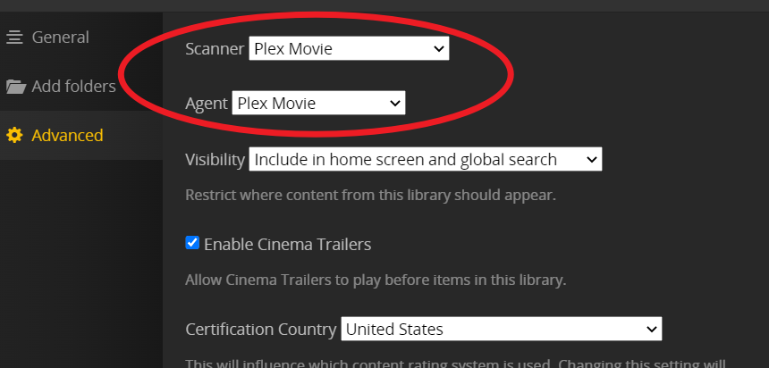

After you’ve upgraded to the new agent that page and those settings no longer apply.
The settings for the Plex Movie scanner/agent is located under
3 dots next to the library → Manage Library → Edit → Advanced
Thanks for you reply.
I checked my server, it’s the same, I am using Plex Movie scanner and agent,
