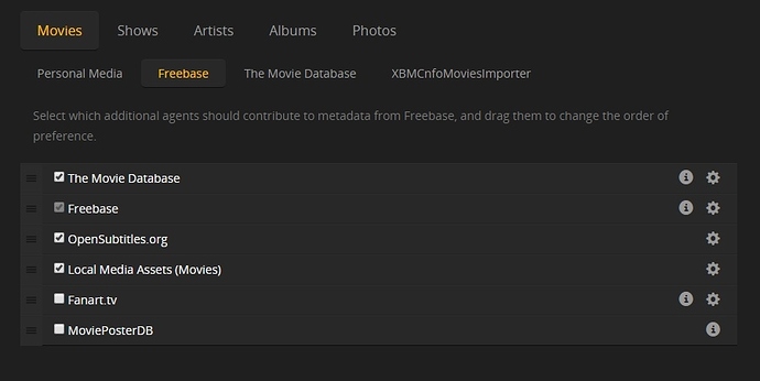

I’ve confirmed that you should be able to use freebase for your trailers, but set the movie database above in priority - https://support.plex.tv/hc/en-us/articles/200241558 - so that the actor data comes from there. There doesn’t exist any either-or choices.

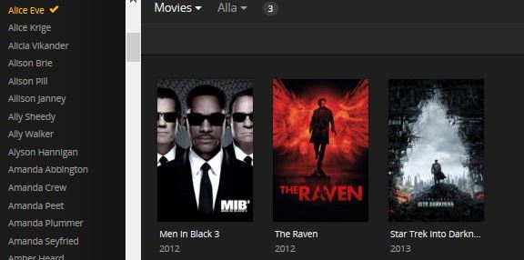

If you view the XML for the Star Trek: Into Darkness does it have her listed there?
I use Freebase for my library and never switched to theMovieDB (Simply because I don’t really search for the actors/actress because with larger servers most of the apps get overloaded trying to list them all)
But doing a search for her in my library I get:
And this is what I am referring to looking for in the XML:
Yes, I checked Alice Eve in that movie too - and it works for me as well

My search for Alice brings this up.
Where its missing ■■■ and the City 2, Star Trek: Into Darkness, and Night at the Museum (2014)

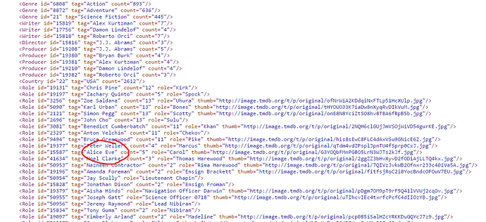

Here’s a link to how you get the XML data
https://support.plex.tv/hc/en-us/articles/201998867-Investigate-Media-Information-and-Formats
For Star Trek: Into Darkness
Its exactly the same until it gets to Peter Weller and then it just stops.
The XML showing that the actors are missing means the information isn’t in the server. When I look at my xml for the movie (And I have it in two different libraries both with the same extras and actors) I have way more (98 total) than the 10 you have listed.

This is how I have my Freebase agent setup, I moved themoviedb above freebase because I wanted the collections back in the day, but as I mentioned above these filters don’t work too well for me with larger libraries so I dont use them anymore. This should also arrange the cast in a better importance :

You are correct about the 10 actors listed. I have double checked my other movies and each movie that I have checked the XML code, it only lists 10 actors and then stops.
example: ConAir
That has to be an issue I’m sure.
Should I re-post this question since I think we’ve found the main issue? 10 actors in the XML data…

This was my setup. Someone said that IMDB cache was the old way of using The Movie DB? yours actually says TheMovieDB. Confused.
