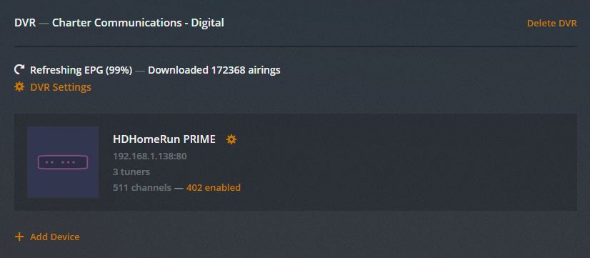

So I went back through my channel list (again) and tried removing a couple more channels with still no resolution. Just to show that it’s even updating all the way, I screenshotted the process.
Nonetheless, whether the SONLIFE removal worked for you or not, it seems there is a real issue with the EPG data if it fails the entire program guide if one or more channels are out. I think this is something that @Plex needs to correct. Even if one channel isn’t part of your package, is unmapped, or maybe is just out, this shouldn’t fail the EPG. I think I speak for everyone when I say we all paid money not just for the Plex Pass to get these features, but for the hardware required to do so. I think we can all deal with the intermittent temporary outages here and there, but for me and @Righton, this is no longer temporary. I don’t expect anyone on here to be an expert or help me with this, I know in the end this is a forum. However, I do hope that Plex pays attention to their users and issues they have with their product.
