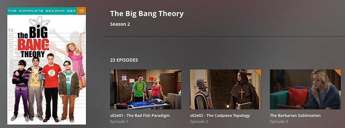

Plex is using File name rather then episode name
I upgraded some of my TV Episodes to a HQ Rip from what I did before.
I deleted the folder and remove the Series from Plex.
Once I had the server scan the new files, it added them to the server along with finding episode thumbnails and descriptions, but for some reason instead of just using a correct episode name for the name it’s using the file name I gave it instead, I tired choosing update metadata and that didn’t fix it.
How do I make it correct the episode name?
Episode 3 below is from my original rip, named slightly different.
How the files are named:
  • The Big Bang Theory - s02e01 - The Bad Fish Paradigm.mp4
  • The Big Bang Theory - s02e02 - The Codpiece Topology.mp4
  • The Big Bang Theory S02E03 - The Barbarian Sublimation.mkv
