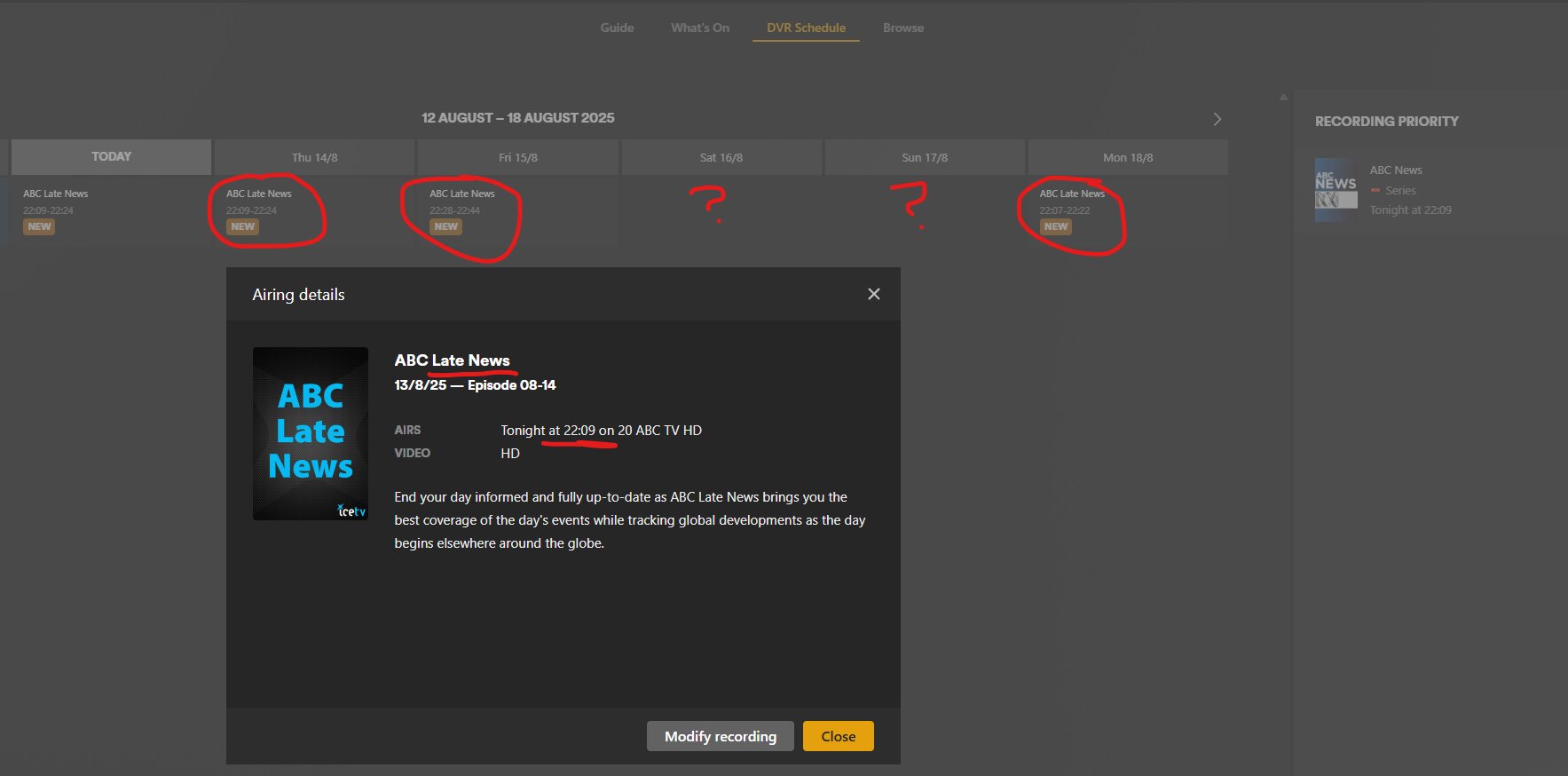

We noticed the recording had failed on the 10th, and when the DVR Schedule was opened the recording wasn’t present, so we just rescheduled the recording. When we noticed that what was recorded was not what we had scheduled, I dug a bit deeper…
The programme I was attempting to re-add was of “ABC News” from ABC TV HD, Ch 20, at 1900 AEST, and this programme can be found in the guide:
After selecting “Record”, the program that is being presented in Record options is different - that of "ABC National News” from ABC News, Ch 24, at 1900 AEST:
This also happens if I try to record the SD version of the news on ABC TV, Ch 2. I picked up on this when watching the first replacement recording we made and saw that it was of the National news, not the local Victoria news - this does happen from time to time when the local news doesn’t air, but not across consecutive nights…

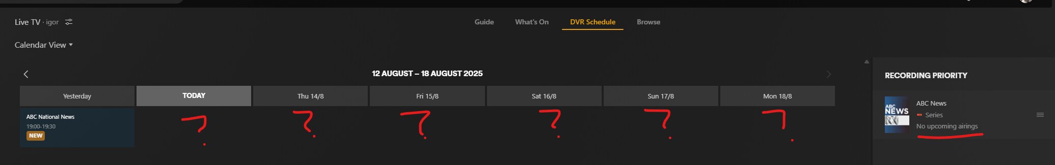

I deleted the scheduled recording & then in an attempt to prevent it defaulting to the incorrect programme on the other channel, I removed ABC News Ch 24 from my line-up of available channels:
Now, when trying to schedule a recording of “ABC News” on Ch 20, I am successfully able to set the recording up:
However, when I look in the DVR Schedule, it shows a News programme from a different timeslot has scheduled to record instead - that of “ABC Late News” from ABC TV HD, Ch 20, at 2209 AEST:
I then further modified my scheduled recording by forcing it to record on the 1900 AEST timeslot, hoping it would pick up my desired programme:
But after saving my modified scheduled recording, the DVR Schedule now shows that there are no upcoming airings of the programme at all:
This is despite the guide clearly shows the ABC News programme is definitely playing every evening at 1900 AEST on ABC TV HD Ch 20 (ref the guide in the first image).

My existing recording also “disappeared” and my attempts to setup the recording again showed the same symptoms as yours. Also observed the recording schedule picking up other more distant recordings such as your example
