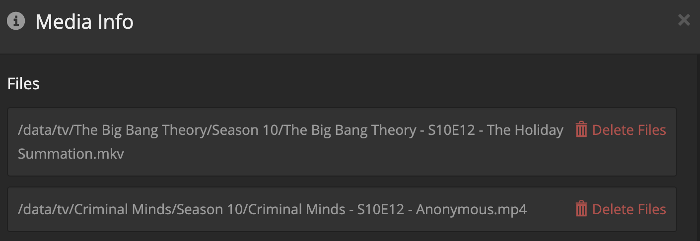

Plex matches episode from a different TV Show
Server Version#: 1.21.0.3711
When I try to watch Season 10, Episode 12 of Criminal Minds, it starts playing an episode from The Big Bang Theory (S10E12 as well). I’ve seen cases where Plex mismatches an episode due to incorrect naming, but these files are both named and structured exactly as Plex does in their documentation. I tried “Scan library files” to see if it would resolve, but it doesn’t.
Any tips on how to fix this?

Actually all I had to do was take the agent steps you posted, also unchecking Local Media Assets, and everything else except TheTVDB and The Movie Database on all tabs… Then I repointed the library to an empty directory and scanned so it would remove all the bad matches. Then I repointed to the correct directory and the scan upon saving the library fixed it all.
