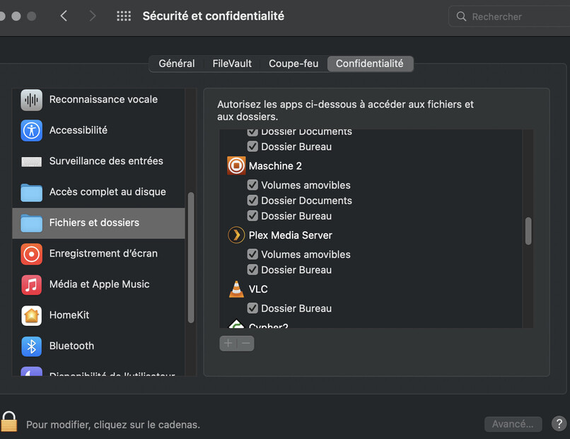

The logs say Plex fails to access the file (“operation not permitted”).
Have you configured your Mac to allow Plex to access media on that drive? → System Settings > Security > Data Protection; there should be a “Files and Folders” section where you can specify what types of volumes certain apps can access.
The access was already granted. I removed it, rebooted, granted the access back, but it is still not working at all. Same error message.

Regarding the macOS data protection settings…
What kind of drive is that volume located on (e.g. internal, external, network)? Does the Plex Media Server entry have access to all applicable types?
Access isn’t usually revoked just like this…
I’m using an external hard drive. I just double and even triple check and Plex Media Server has access to all applicable types.
I tried with a USB memory card and it works. So there must be something not working between Plex and my external Drive (that is working very well with anything else).
So your Permissions look like this.
Yes, it is and it was.
I even tried by unchecking it, no difference. Checking it back, no change.
