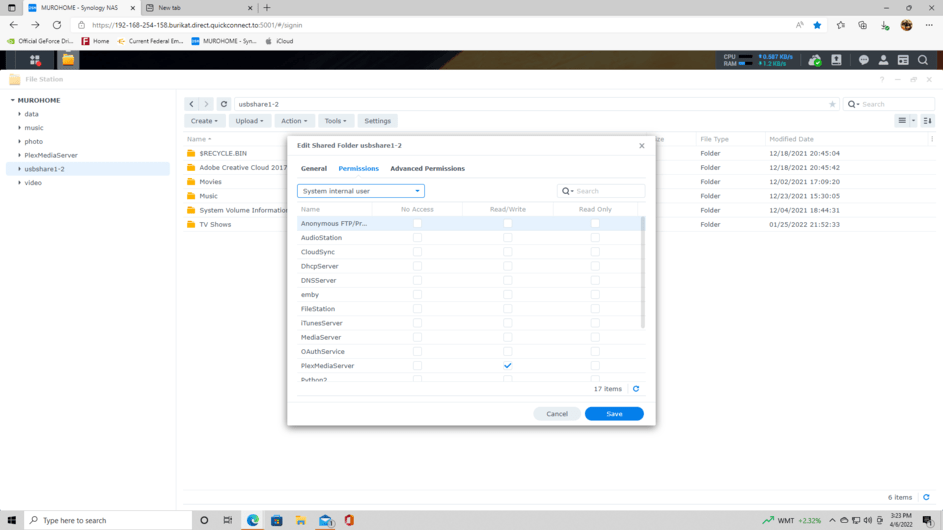

Yesterday I upgraded by Synology to DSM 7. Since then plex is unable to access my media files that are stored on my NAS. I have updated permissions for the new ‘PlexMediaServer’ account on the ‘PlexMediaServer’ Shared Folder, and on the Shared Folders that hold my media.

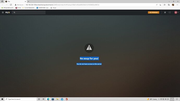

Somehow, the server seems unable to access my media files. When logging in to Plex using a browser I get an error message "No soup for you! You don’t have access to this server’ (see attachment).
Anybody who knows what to to?

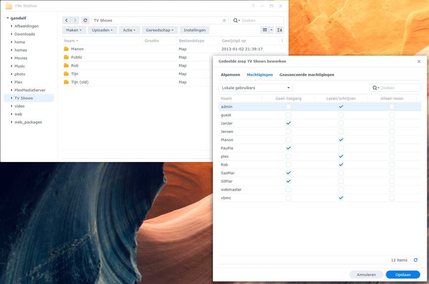

To start with the issue of the permissions on the Shared Folder:
Both my ‘TV Shows’ and ‘Music’ Shared Folders are setup to give Read/Write access to the account ‘PlexMediaServer’ (see attachments). As you can see in the screenshots, there is also no button to ‘Create’ the new Permission rules. Am I missing something or doing something wrong?

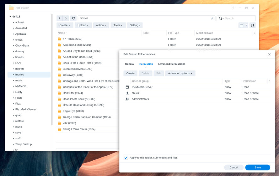

Here is an easy way to add the permissions for all files in the shared folder.
  1. File Station
  2. Right-Click on the shared folder
  3. → Properties
  4. Permissions tab
  5. Confirm all the permissions are correct (Create if you need to add something)
  6. Check “Apply to this folder , sub-folders, and files”
  7. SAVE
It will apply to everything.

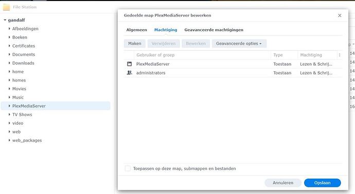

This page
Hi ChuckPa,
I just tried the procedure you described above. I see two differences:
  • Below the menu bar (‘General’, ‘Permissions’, ‘Advanced Permissions’), I don’t see the buttons (‘Create’, ‘Delete’, ‘Edit’, ‘Advanced Options’).
  • The checkbox ‘Apply to this folder, subfolder and files’ is also not shown.
Is there a way to fix his, or another way to propogate the permissions down to folders, subfolders and files?
See the attachment.
@rob_hooi
Thanks for the screenshots.
I think I see where you missed what I’m saying.
  1. You clicked TV Shows
  2. It looks like you clicked something else after that ??
I did the following:
  1. Clicked acl-test
  2. Right-Click acl-test → Properties
I tried to screenshot the process.
  1. Right-click the shared folder , see “Properties”
  2. Left-click “Properties”. See the properties page open
  3. Look in the lower left corner of the popup. This is where the checkbox is.
  4. See also the “Create” button where you can add “PlexMediaServer” to the list if it’s not already showing there.
Hi ChuckPA,
I did everything as you described: left click the Shared Folder (‘TV Shows’ in my case). Then right-click the ‘Shared Folder’ and choose ‘Properties’. Then the window pops up. Click on ‘Permissions’. As you can see in the video the buttons in the top of the screen are missing, as well as the checkbox in de bottom left corner.
Is it possible to set the correct persmissions on the Linux level?
Kind regards
Video.zip (3.7 MB)
@rob_hooi
Thanks. I see what’s happening.
You are looking at Local User . You have user Plex selected.
DSM 7 changed this.
  1. System Internal User - Click on “Local User” and change to “System Internal User”
  2. Username is “PlexMediaServer”. Delete username “Plex” (Control Panel - Users)

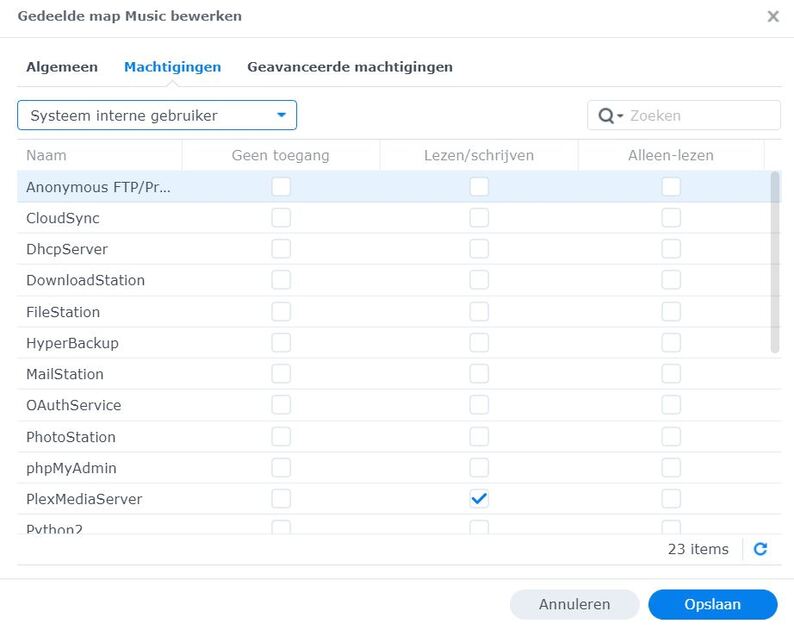

When you have selected “PlexMediaServer” and “Save” that, you return to the previous page.
You should now be able to “Apply to this folder, sub-folders, and files”.
Thank you. I have deleted the ‘Plex’ user, but I am afraid that the buttons and checkbox also don’t show up when ‘System Internal user’ is selected, as you can see in the video I attached.
Video2.zip (5.5 MB)
I do get the buttons and checkbox when I select another Shared Folder like ‘PlexMediaServer’. See attachment. Is there a difference of some kind between my Shared Folders ‘TV Shows’ and ‘PlexMediaServer’?
