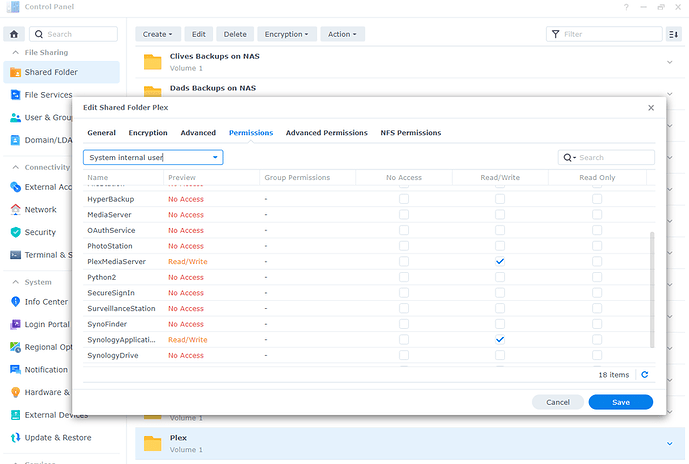

  • PlexMediaServer the Custom checkbox mentioned in ChuckPA guidance no longer exists in my version of DMS7 or I am looking in the wrong place (see screenshots)
  • There is no option offer made to click Apply permissions to this folder, sub-folders during my install
  • I am not sure what additional permissions I have to give PMS in order to satisfy its needs to allow the install to proceed

You show READ/WRITE . This is incomplete.
It must be Full Control and Apply to this folder, sub-folders, and files
If you cannot do this, Please let me know. There are known rare cases where the “Custom” button doesn’t exist but we know how to resolve it.

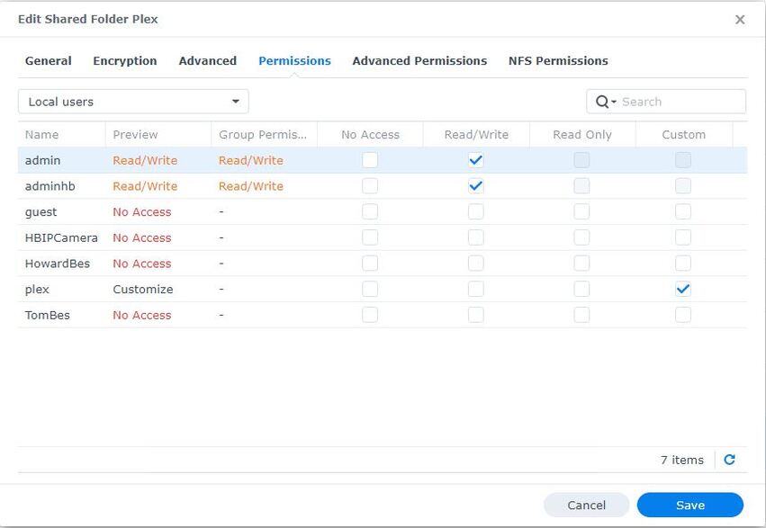

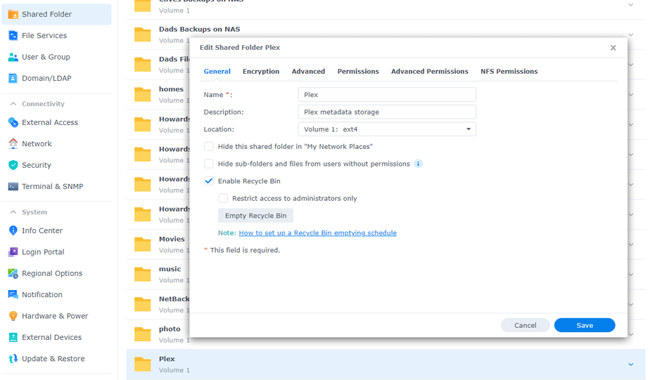

Thanks for the reply, as I said in my original post my screens don’t look like yours, below is how I am accessing the Plex shared folder
I do have a plexmediaserver object listed under permissions tab but I only have read\write options available when editing permissions there is no “Full Control” option and no tick box at the bottom of the screen to apply changes to this folder, subfolder and files only a “Save” button

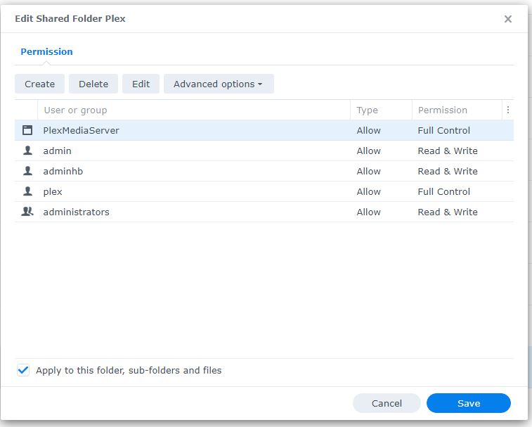

When I access the Plex shared folder permissions I now see the “Customise” option allows me to set permissions for the PMS so as you can see I set permissions for everything admin rights, read and write permissions
Clicked Done and I can see that PMS has “FullControl” ticked the box to apply rights to this folder and any subfolders and files
Clicked "Save and the permissions tab now looks as shown below
Clicked “Save”

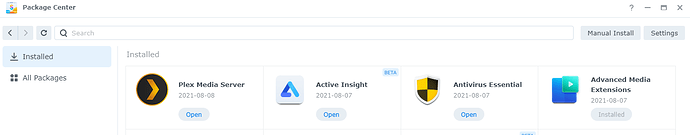

Attempted the manual install again and this time it succeeded .. Yay!
Looks like I have access to all my media playable from my PC and from my TV using Plex
