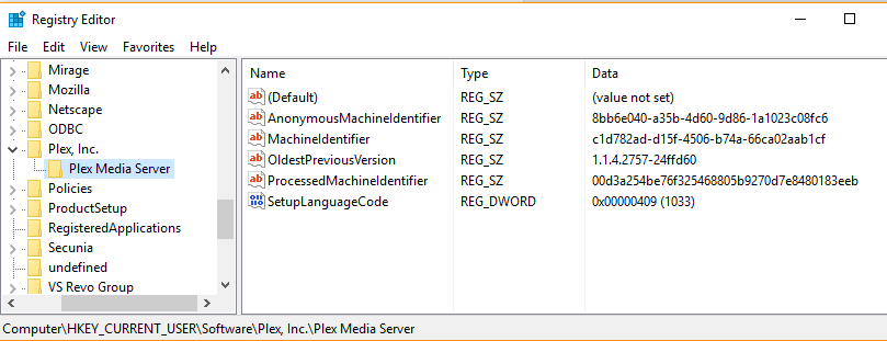

To check the first, have a look at this registry area HKEY_CURRENT_USER\Software\Plex, Inc.\Plex Media Server and look for an entry named LocalAppDataPath - delete it and launch Plex Media Server
@sa2000 - thank you, I did see this on the previous post and tried it all before posting today. There is no ‘LocalAppDataPath’ entry in my registry (see attached image) :
. I also did a full search of the registry and nothing came up.
I have never had Plex running on this computer as previously I used a really basic media centre (PlayOn) - I had Swiss Centre before that. Any other ideas?

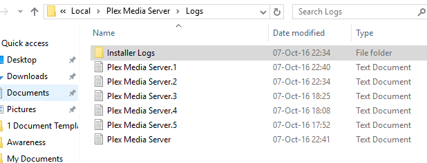

Can you see if there is a Logs folder within %LocalAppData%\Plex Media Server
Note that these folders are hidden and need to set windows folder options to view hidden files
Morning! Yes there is a logs folder
please zip and attach
Zipped and attached - thank you!
