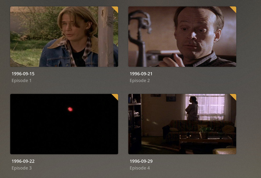

So this is how it’s organized on my Synology Drive.
This is how it looks on Plex. When I first uploaded it, it had some episodes and titles and yes, even IMDB details inaccurate as some shows were 2 parts, so I went through and found the right titles and details and input the right info on my Synology Drive.
All I want is for the S00E00 Title as I put on my Synology drive, to show up like that on Plex.

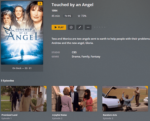

When I try it on my system, I get an immediate match with correct episode names. I’m using TheTVDB as an agent, and it is configured as shown above. Running PMS 1.20.3.3437 on a DS918+.
File naming:
/Test TV Shows/Touched by an Angel/Season 03/Touched by an Angel - s03e01.avi
Library set to use TheTVDB:
Plex client, Season 3:
