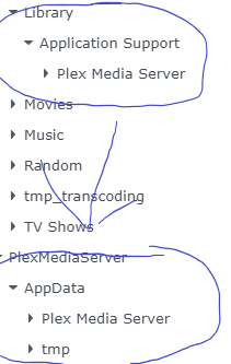

This appears to have been resolved. Fortunately when upgrading I didnt realize my metadata was in the same folder as my media. When upgrading DSM and reinstlling Plex it created a new share called plexmediaserver. I stopped the plex service. Deleted the plex media server folder and copied my original plex media server folder to this new location and started services. Needed to claim the plex server after I started plex but appears everything is how I left it before the upgrad

Found some instruction on transfer of Metadata to other NAS so I though I would add my original Meta Data which was located ///plex/library/application support/plex media server. I then copied it to the shared folder that was created in I manually installed plex after the dsm update ///plexmediaserver/appdata and my plex looked just Like it did before the update.

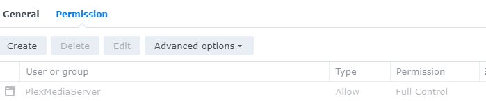

May I see the logs ZIP file please ? Intros not being detected is 99% a permissions problem.

This is also the current permission for one of the shares.
