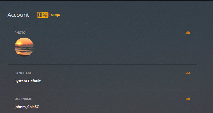

From your Plex server if you go to the dropdown for your Account, top right and choose Account
Does it show your Plex Pass.
@johnm_ColaSC yes, it does show that I have plex pass. Still no ability to set the Live TV and DVR.
