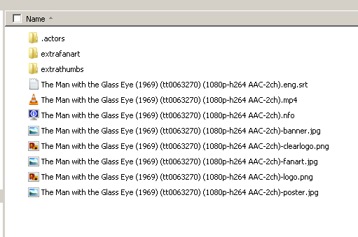

I run a number of Windows PMS servers…
I don’t have much problem with them, I also don’t have to use the extended path.
What version of Windows are you using? I looked through the post and didn’t find it listed.
All my movies and TV series use external (.srt) subtitles
This folder structure just works
Note that the srt file has to have the same exact name as the movie with the added 2 or 3 character language code, I use the 3 (eng)…
see the support docs for additional information.
