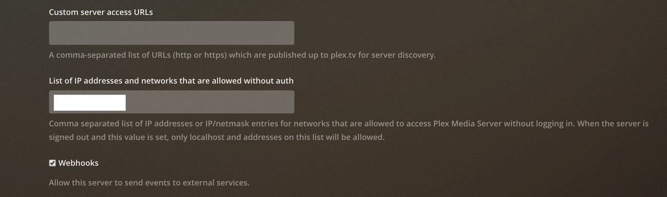

Are your Server network settings correct.
Try using: Sub netMask were networks are allowed without Authorization
Secure connections : Preferred
Router: Reserve/ Static lease your LAN IP for your Server and TV LAN IP
When and if your TV Plex app loads make sure in the app settings, add the server’s LAN IP under Manual server.
You could also try a different DNS in TV Network settings like : 8.8.8.8

In the Plex settings on your LG, make sure you have Manual server set up. Add your server LAN IP and Port 32400
In your server’s network settings, add your sub netMask as below.
