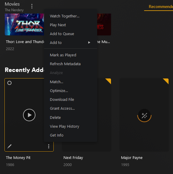

I was able to catch the notifications flash by this time and it did indeed see it. Please see attached jpg for the library entry. Major Payne and Next Friday have been spinning for a couple hours now.
