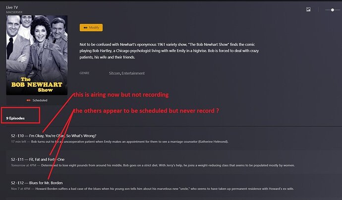

No there is nothing in my libarary. here are some screen pics of The Bob Newhart Show. I currently have nothing in my library. When i look at the series it shows 9 episodes but most of them are scheduled to be recorded. S02E10 says “airing” - currently it is playing but the activity indicator at the top does not show Plex recording anything ?

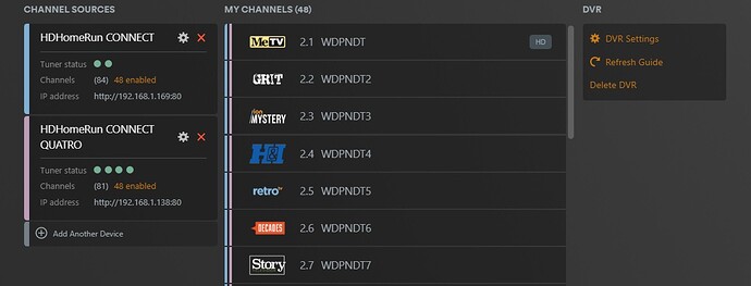

no i havent i will try that. what i have noticed is the non-recording of programs appears to be only on a specific channel and sub-channels. i’m in the philadelphia area and its channel 2 series of channels (see pic) which includes: MeTV, Grit, Ion myster, H, Retro, Decades, and Story channels. is there a way to accidently elminate one channel and the subchannels from being recorded ?

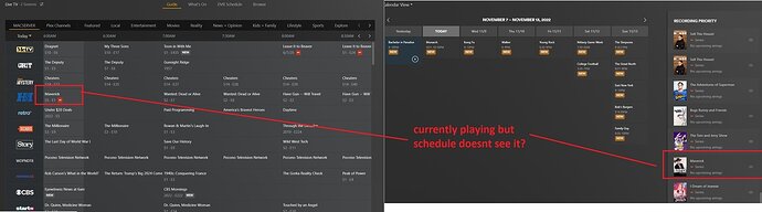

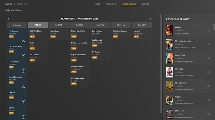

Whats really strange is the DVR Schedule tab displays “no upcoming airings” and the show is not only listed in the current guide but it has the red indicator to record it. So its almost like Plex doesnt know its playing to record it (see attached)?
Like I said, the red marks only mean that you’ve created a recording rule for that program/series. It doesn’t mean that episode will actually record. There are a number of reasons why Plex won’t record a give show/episode:
  • The rule says to record only new episodes and the EPG doesn’t have the episode listed as being new (and the EPG can be wrong)
  • Plex has determined that the episode/program “might” already exist in your library and duplicates are not allowed under any circumstances - of course, this can be extremely problematic when the EPG information is either incomplete or just wrong – HUGE program for sports and also for shows like Saturday Night Live
  • Your recording rule specified a specific channel or time of day and the episode doesn’t match – I found that the time of day rules were not applied in a reliable way
So the red marks in the guide mean nothing. Only the DVR Schedule screen tells you what will actually record. So yes, given how finicky the whole process is, you end up having to cross-reference the two screens and then you are still left scratching your head why something you want to record just won’t schedule to record.

When I am on the DVR Schedule page, Calendar view, I do not see any Chicago Fire listings even though I have it listed in the right-hand column of the same page, but that is because it is set to New Airings only. If I change that recording to New and Repeat Airings and click on Save, the resulting Calendar view immediately lists all the repeat Chicago Fire episodes on ION TV.
