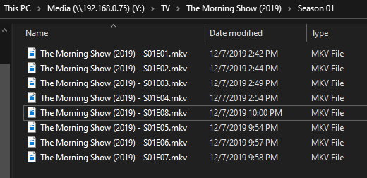

Thanks for the suggestion. I tried the Plex Dance with The Morning Show. I really was hoping that would work. Unfortunately, after copying 8 episodes back into the folder, Plex was kind enough to show that there were only 7 added.
I have a feeling this is more to do with the naming and directory structure you’re using than anything to do with Plex’s interaction with TheTVDB. Please try putting this show in this path with these file names:
TV/       <- Your TV Shows library should point here, the name does not matter
     The Morning Show (2019)/
          Season 01/
               The Morning Show (2019) - S01E01.mkv
               The Morning Show (2019) - S01E08.mkv
Then go through the Plex Gymnastics again.
The full guidelines for TV show naming can be found here:
This appears to be one of those cases where it seemed like the naming you’re using was fine but eventually falls down. It happens a lot unfortunately. If this still doesn’t work after doing the above, you may want to create a dedicated thread for more in-depth troubleshooting.
I was curious whether the renaming would work. It really shouldn’t considering that I’ve got hundreds of TV episodes across a few dozen shows already and they all work just fine. It’s just these two that don’t. Plus, I’m quite familiar with the naming patterns, having added 35+ seasons of Doctor Who to my Plex over the years. Still it’s possible that something changed and now naming formats have to be exact so I gave your suggestion a try to see what would happen. The result was very interesting. You can see in the screen capture below that I’ve named the files exactly as recommended, and the top line shows the folder path (TV\The Morning Show (2019)\Season 01).
So, what happened? The series now doesn’t show at all. Nothing. Not a single episode. Now that is odd.
Next, I moved the 8 files out of the “Season 01” folder and into the parent “The Morning Show (2019)” folder. That caused Plex to add the show to the library, but only with the first 7 episodes. Episode 8 is still missing. In a way I’m back to square zero.
