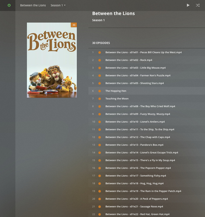

My kids have a show Between the Lions. It has full episode information available on thetvdb.com. For Season 2, it works perfectly. For season 1, it only downloads the title of epidsodes 6,7, and 24. All are available on thetvdb. Posters and banners work correctly. Any idea whats happening?
I’ve removed media, cleaned bundles, emptied trash, readded media to the same result.

Right now it just says “episode X” for titles where X is the number. Doing it for a few shows.
Attached screenshot
