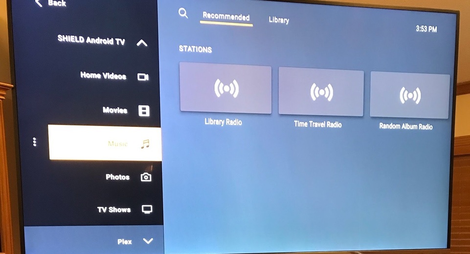

I reset my Nvidia shield and updated Plex. I am only seeing the categories and not the Live TV & DVR. Any feedback would be greatly appreciated! See attached picture below..
Clearly see it’s not there… as Revnu said… did you add your DVR to plex? Guess mine has always shows up due to me having that tuner added.
