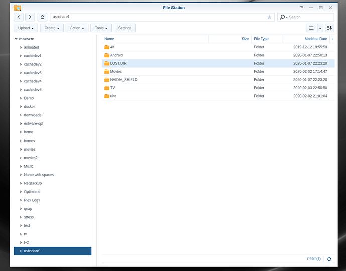

I am not understanding . As secondary test, I grabbed a NTFS drive I have for migrating between systems.
  1. File Station saw instantly
  2. PMS was able to go right to it.
