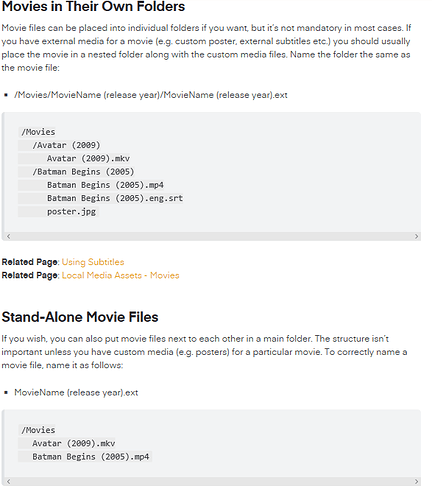

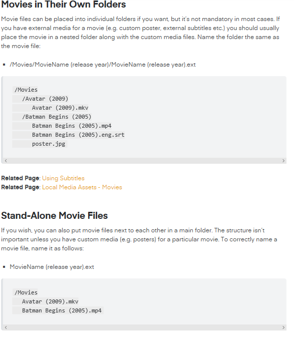

Hello. I would do away with the idea of a folder for each movie. The only time you need this is when you have a movie with more than one part. I have all of my movies in a single folder (Movies) and I point the Plex media server at that folder. I have a separate folder for TV Shows. Naming convention should not stop you from seeing them, but could alter any meta data you might see if named properly. Also, either set your plex to scan your library automatically (to start), or force a scan after your make changes to the files/structure. That way you will see what your changes have done immediately.
Plex naming standard is a folder for each movie.
This allows extras to be placed WITH the movie and avoid interfering with other movies.
I have never had more than one folder for my movies. Movies CAN be put in their own folder, but it is NOT necessary unless they are Multi-Part movies. I have never had an issue and as you can see below, it is an acceptable best practice from PLEX.
It is true, if you never have extras, you can put them in one folder.
Most users eventually do end up with extras so it is best practice , hence the standard, to start this way from the beginning. Curating is much easier.

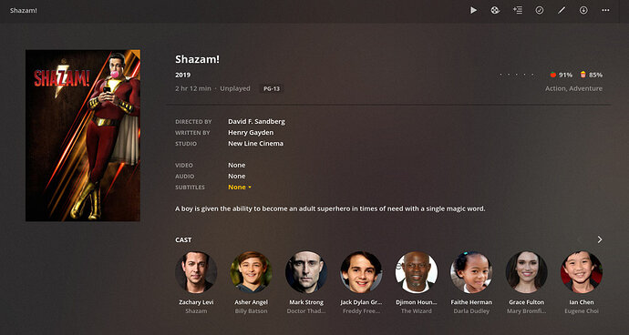

I did the dance but still no difference. Since troubleshooting this, another download has finished for Alita Battle Angel and the folder is showing up in Plex but again, not the movie itself.

One of the affected files is called “Shazam! (2019).mkv”. How do I view MediaInfo?
