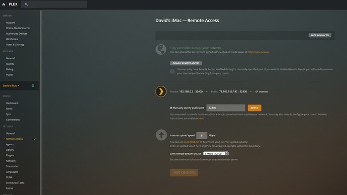

Do you have multiple port forwarding rules going to the same local IP in your router? I see it trying to map 32402 and 32400, or were you just trying different ports?
I was just trying different ports to see if anything worked. I even tried UPnP to no avail. I read some other posts that it could be something with plex.direct domain being blocked (I did not see those blocks in Opnsense or NextDNS logs though.
I have the same issue - desktop shows connected then soon after - disconnected
I will say this that this is fairly inconsistent. Sometimes it works really well and other times very sporadically. It’s one of the reasons I am looking for a more stable way of remote accessing my media files (and sharing). I just can’t depend on Plex to always work. The one way this issue is consistent is that I have the same problem if I run PMS on my Synology, NVidia Shield, Docker or Unraid. They will will just start working again until the next time it stops. I loathe to update my server/firewalls with the fear that this will bring down PMS.
That’s a new one I have not seen a reference to the external (source) port being 49200. I had though that you needed 32400 to whatever internal port you had your Plex server listening to (Ex: 32400 to 32400 or 32401 etc…). Is 49200 something new?
only the internal port needs to be 32400. Nothing special about 49200. The external can be anything, as long as it is not used by some other service. (like if you play video games on the computer it may use particular ports) Many folks just use 32400, 32401, 32402 etc just because it is easier to remember.
This has worked for me… no drop-out in 24 hours at least! Thanks

I have absolutely no option to enter an external IP address or port? I so frustated, that after going to DSM 7 the whole remote access broke. I have one port forwarded in my router which is my local IP address with the 32400 port. It has worked fine for the last 3 years, but I should have never updated to DSM 7 ffs!! How can I fix this :frowning:
