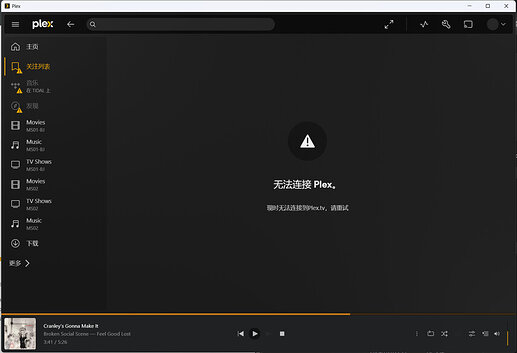

There are also problems with other Plex services. Other than the metadata service, I cannot access https://plex.tv, the discover, watchlist, and “Music on Tidal” page either. Also, my avatar in the Plex app is not displayed properly. I have attached the screenshot below:
