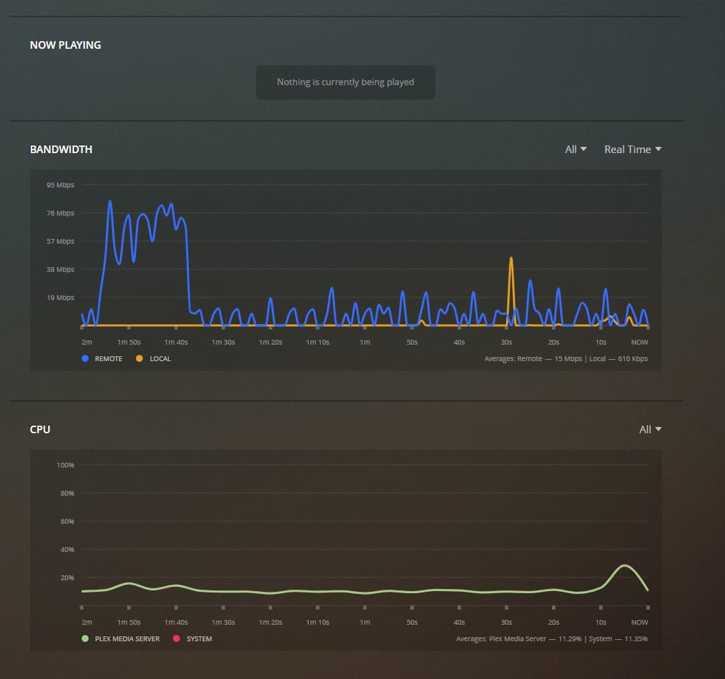

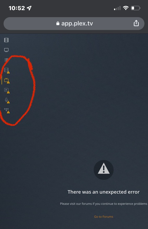

After this update my server is crashing. The dashboard is also blank which preludes the server crashing. The UI on app.plex.tv becomes unresponsive. I have to restart the plex server to get everything to come back.

When this happens does the dashboard say “unable to load statistics”?
No. It just says nothing is playing. When I navigate to another setting it says unreachable. Then the server dies
Does the server completely crash or does it stay running in a deadlocked state? Meaning the app is still running but unresponsive.
I looked at the deadlock thread, but I dont see anything mentioning deadlock issues in my logs…I only have Tautulli running…I was running Overseerr a month ago but I killed it because the API was killing my plex server.
So it looks like something is playing from the bandwidth graph but nothing shows. hmm weird. Never seen this one before.
