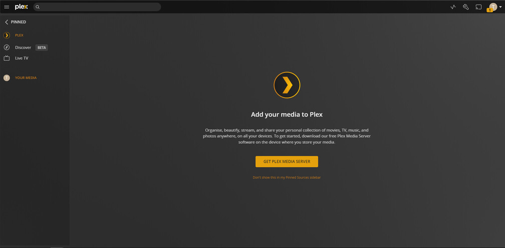

hi. that is not possible,
please refer to the screenshots
thanks

Please tell me what I’m missing?
How are you opening/accessing your newly installed server (I assume this is a new install)? Are you on the same machine, the same network; accessing the server using a browser or some Plex app?
via the IP on the machine its installed on,

Im on the machine PMS is installed on using the IP to bring up the two screenshots.
