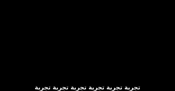

I have the same issue in unraid, when I use Direct Stream/Direct Play the fonts works without any issue,
but when I transcoding it, it gives me a weird shape.
Back in the day when I was using windows all I have to do is installing the fonts that being used in ASS file, even in SRT when it not used the default font.
unraid Direct Stream/Direct Play:
Imgur
unraid transcoding:
Imgur
windows Direct Stream/Direct Play:
Imgur
windows transcoding:
Imgur
