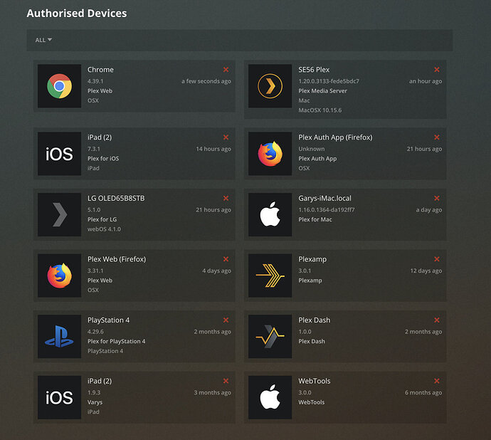

I wake up in the morning and the server isn’t running. I have to manually start it.
Started roughly 2 weeks ago. I can’t remember if anything changed around that time.
Server Version#: 1.16.0.1364-da192ff7
Mac OS 10.15.6
That is not the server version. That’s the current version of Plex for Windows.

Sorry Plex server. 1.19.5.3112-b23ab3896
